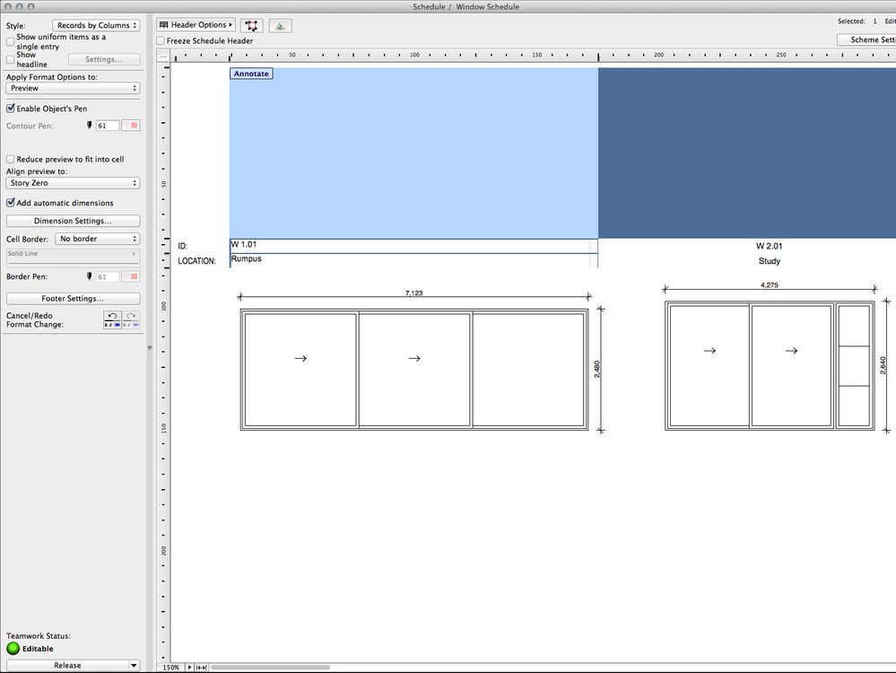

Hi There,
In the window schedule the preview for the windows appear below the actual row that it should be on. (see screenshot)
Now this is affected by the - "Align preview to" setting, but it should be set at story zero for every window to appear at the same level.
Either something funny or dumb is going on here. What have I missed or what is going on? Suggestions?
Thanks

Sounds like a row height issue to me but a screenshot of the schedule would help. You can use the button with the dots [...] on it in the top left corner of the schedule to edit your row heights. Make them really big then use the slider on the left of the schedule to manually drag them to fit. Or you can double click them between rows to auto fit.
