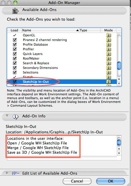

I downloaded the new SketchUp Import Add-On, but after restarting..... I don't see it in any of the AC15 work environment profiles (or in the list of commands). Add-on Manager shows it is there.
What did I do wrong?
AC15 trial.... 64bit Mac

When you go to these Dialogs, you should be able to select the format in the file types list.
It is not something that appears as a menu item, but a new choice among selectable file types to open/save as.
Stress Co_
Thanks Laszlo. I see it now.
Use "Merge"...... enable "Google WH SketchUp File" to import.
It is kind of weird that the add-on provides support for Open and Merge, but not for Open Object... since the add-on converts the skp file to an object. Would make sense that Open Object handled skp just as it does dwg, but GS puts 3DS and skp into yet different places even though they create objects.
Anyway, yup, "Merge" is what most people will want. And, its great to finally have this running on Macs. 😉
