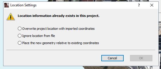

I have a 'location setting' error message when dropping it in.
I've tried all the options and nothing happens, I can't see the file in plan or 3D
Sorry forgot to mention that the issue with dropping it in is with the kmz file type.

Maybe the solution is what the error message suggests: that you should save those files from Google Earth with the Absolute Altitude method and see if those come in properly.
