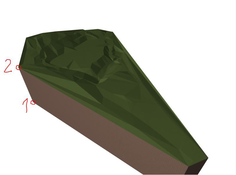

I have used that command, is very quick, but the result is somwhat strange (see the attached example):
1. the hight of point 1=-1000, point 2=-5000 (???)
2. if I change z value of the point 2, it is the point 1 that moves (???)
Maybe some other user can explain these?
