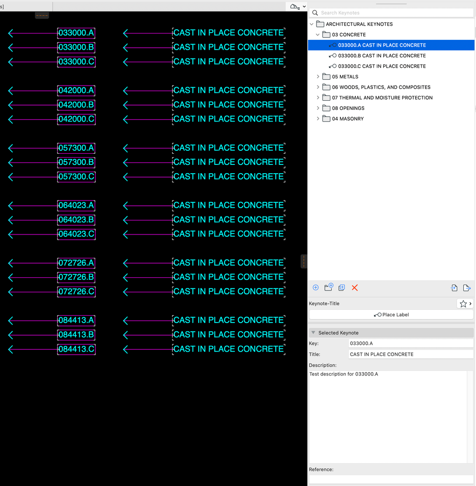

I may have the same issue as @fabioferrini's original #2 concern:
Our firm standards dictate that we have two format types for keynotes:
  1. "Key" only, with a frame, for drawings at 1/4" scale or smaller (plans, building elevations, etc.)
  2. "Description" data only, without a frame, for drawings at 1/2" or larger (details).
I have created a Favorite for each of these formats. When creating a new keynote from the Keynotes palette, these favorites work great. However, if I want to apply the favorite to an already placed keynote, the specific keynote data that was referenced when the Favorite was created comes with it. This means that if at any point someone needs to change the format of their keynote, they have to not only apply the Favorite, they also have to find the correct keynote again and "Replace Label" from the keynotes palette. I attached a photo for reference, in which I applied the "Description" Favorite to the right column of keynotes (my Favorite was created from 033000.A).
@fabioferrini mentioned this, but there are no "Keynote" attributes in the element transfer settings. This means you either get all settings transferred (not only the keynote data types being referenced, but the specific keynote itself), or the label content is ignored all together. This wouldn't be a huge deal if the Favorites behaved as desired.
