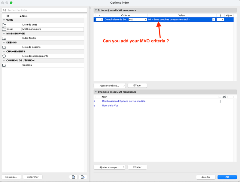

BrunoH
Hi Runxel,
in the views index can you add the MVO with the "10 WIP" as a criteria ? does it the list the views ?
can you then change the MVO ?
I suspect that MVO are compared by names, not by indexes like other attributes and that characters encoding can cause the problem.

runxel
Yes it shows all of them, even when it the view says its "missing".
