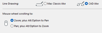

Oh. Now I understood what you meant, as a blender user myself.
Unfortunately, I do not think that is possible within Archicad settings (even after looking it up online to see if someone faced similar issues). There is a setting in the work environment - input constraints and guides, but it does not seem to alter what you asked because it only treats panning and zooming not orbiting and panning:
