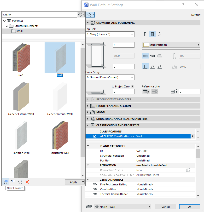

You can create Favorites elements, it stores the Layer for each favorites you save so you don't have to change every time.image.png
