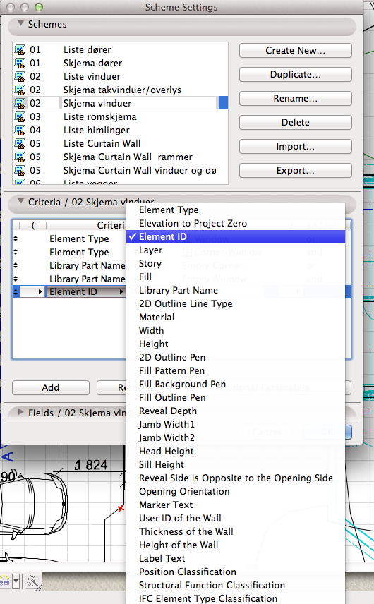

There seems to to be no corresponding field (Location) to query by in the Scheme Settings dialog.
What am I missing?

Open the Fields panel, click the Additional Parameters... button, then browse to and select one of the windows that has the parameter you want to add. Look through the Available Parameters list to add that parameter to the Selected Parameters, and it will be added to the Schedule Fields.

Another solution is to filter by ID. This is how I typically do it. Change the ID of all existing windows to EXISTING. Then exclude them from the schedule criteria. Simple, fast, easy. You can also exclude empty openings in the same manner (label them EMPTY, for instance).
Or if you can, filter by layer, so only include windows/doors on the walls.new layer (or however you label new construction vs. existing construction layers).
