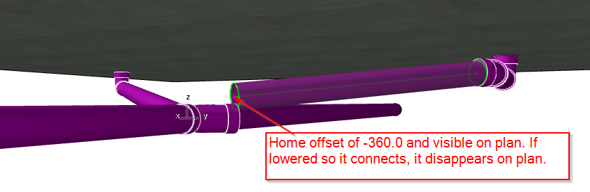

I have some pipework that disappears on plan when the end elevation is set past a certain height below slab.
My floor plan cut plane is set to show 3 stories below, offset by -5000 mm. The pipe is set to show on all stories. Renovation filters are not affecting it.
In 3D if I raise the end elevation of the pipe as shown in the attached screenshots, it appears in plan. When I lower the end of the pipe below a certain elevation, it disappears on plan, but can still be selected and still shows the end grips as seen in the attached screenshot.

I don't seem to be able to attach 2 images to the same post, so here is a 3D view for clarity.

The attached image perhaps shows it more clearly.

I'm not sure I understand. The pipe object does not have a symbolic display option.
In my experience even if I set the pipe to display on All Stories, it is not visible on any story. I can select it, but the object does not show.

alemanda
you have symbolic view.
CTRL+T to open settings of your pipe part.
See "all parameters"
Go to "2D representation" and enable the symbolic view.

Eli Chiasson
Ah, thank you!
