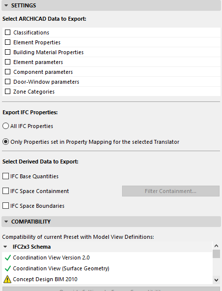

I've encountered an issue when exporting an ifc:  there seems to be some properties that Archicad controls itself and are not accessible via property mapping. I cleared out all Psets from the Property mapping, and all the boxes from data conversion but there are still a lot of ifc data that Archicad saves and that I can't seem to be able to control.
Is there a way to clear all that or some of those tabs from the ifc export? and save only some selected properties? or at least change how that data is being extracted and named in ifc exporting?
While I understand most of them are useful, in my case the BIM manager requires specific metadata exported, and while I can create a custom pset that mapps ifc properties from specific Archicad properties according to the requirements, I can't delete or change the name of the the properties in those tabs.
Usually it's not a problem but in this case there are conflict between the names bc several properties are saved with the same name( one mapped by me, one mapped by Archicad) that will show different information and my ifc gets rejected - they use some sort of automated script that searches for specific text for ifc properties and does not allow duplicates and ofc does not allow inconsistency.

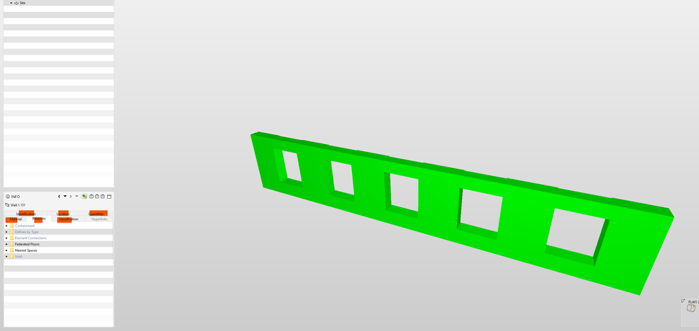

There are multiple issues I've received but for example under the Identification tab there is the "Type" property that shows either the composite name, or the building material name or the custom profile name for walls, slabs and roofs or " railing type" for railing or the library part name for windows and doors etc.

If it's just renaming and it's predictable where it ends up in the IFC file, you can use a post-export script to automatically rename the problematic property set. Any programming language can do this. Or if you are knowledgable with Python and understand the IFC scheme, use the ifcopenshell library to fix the IFC file in one go.
That said, be aware that the tab that Solibri shows is its own interpretation, based on the materials in the model which are referenced by elements. There is no property set called "Material" in the IFC file.

Yes, Solibri "friendlyfies" some of the IFC information. All "tabs" up to Hyperlinks in the INFO panel are NOT property sets, but is Solibri collecting information into a decent overview:
  • Identification - bits and pieces from different places (attributes, representation, file info...)
  • Location - bits and pieces from LocalPlacement and containment relationships + calculated info from the Bounding Box
  • Quantities - NOT the BaseQuantities, but Solibri interpreting the geometric representation (!) This info is derived by Solibri but cannot be found as-such in the model
  • Material - names of references materials and thickness if a MaterialLayerSet is referenced. No material properties are visible, that I'm aware of
  • Profile - name of the profile as referenced inside the geometric representation
  • Relations - various objectified relations (via the inverse attributes in the entity/class)
  • Classification - combination of Classification References from the IFC file and Solibri-generated classifications from the loaded classification rules (= interpretation)
  • Hyperlinks - Solibri-provided URLs (if I'm not mistaken)
Moreover, there is no "ceiling" class in IFC. What Solibri shows as ceiling is in fact an IfcCovering with PredefinedType CEILING.
And there is no instantiatable "object" class in IFC. What Solibri shows as "object" is an IfcBuildingElementProxy.
