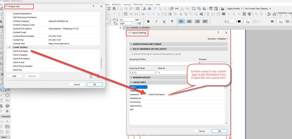

Is there a way to add information from Project info (or Properties) into Layout info?
Why I want this is because I want to export an excel in order to automate a sheet register with a proper header (green part) to the Layout info (the red part).

Maybe I misunderstand what you want to achieve, but what is preventing you from just using the Project Info Autotext instead of the Layout Autotext, if it's even the same? 🤔
Mats Knutsson
I want to export an excel with layout info. One row per layout just like a regular sheet index but I also want to add some selected data from Project info into the same excel so that I can automate the creation of the sheet index as in the example attached (the header page of the sheet index marked in green and the layout info marked in red...usually we do this in Word and export to pdf...).
