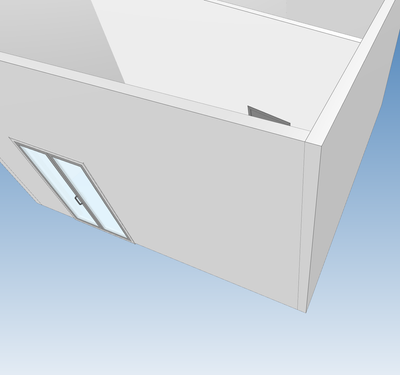

We are having some trouble with IFC wall geometry not intersecting properly when it has an opening in it.
IFC used the general export translator.

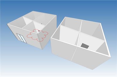

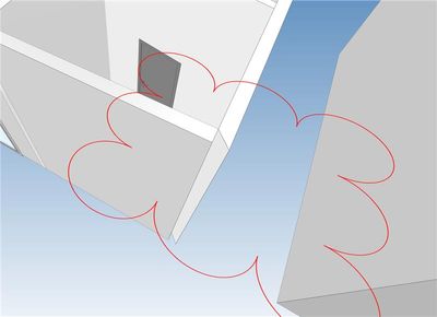

A model with an opening below shows weird intersections with that wall. An exact copy of the model with the opening removed below shows fine intersections.
Model in Archicad with fine intersections.
I have tested this with all existing and all new renovation statuses and got the same result.
Exporting using the exact geometry method helps but not a mitre joint like other walls.
