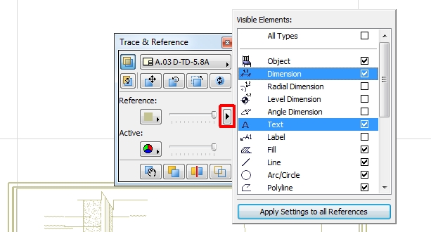

Problem 1: Disappearing Text while in Trace Reference
In autocad, some texts are written directly at autocad layout instead of autocad viewports. After merging autocad layouts into Archicad layout, the text could be seen. However when using Trace reference, the text seems disappear. (Figure 1)

Problem 1. As a default setting of Trace & Reference texts and dimensions are hidden. If you open the Trace & Reference palette, you can set individually to show or hide any element type on the Trace. (see attached image)

Thank you so much for your great help! My question one was solved, and my question two could be explained!
