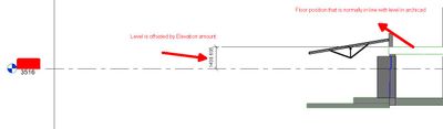

We received IFC file from Archicad that is georeferenced. After we imported it in Revit it seems that model phisically goes at its position, but levels used in Archicad seems to be tied for elevation of internal origin i.e 0,0,0 . not with real world elevation that is defined in survey point in Archicad. Is there a solution for this kind of problem?

In Revit you can have as many levels set up as you want, but you need to have levels set up in such way that you only activate the "Building Story" on levels, which were agreed upon the whole project BEP - the same ones you have in Archicad.
Maybe that will solve your problem.
