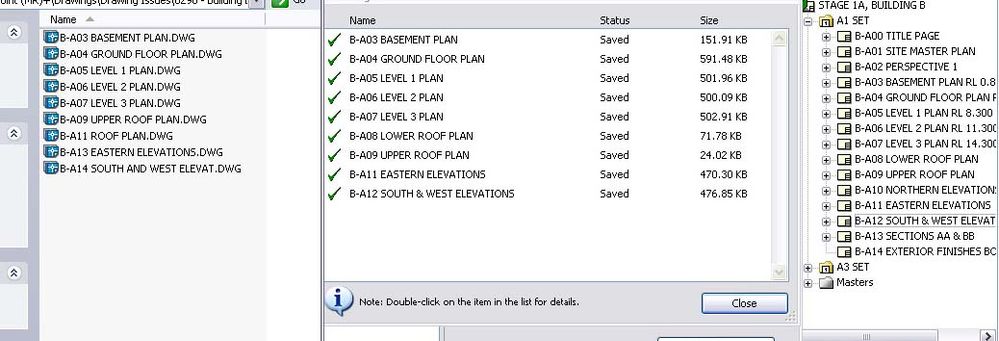

Hi guys,
I hope you could possibly shed some light on this issue that i've just found.
I'm trying to publish a few drawings from AC 10 to dwg format and with each and every one of the translators it changes the names and drawing numbers of the end DWG's. Ref. to attached image showing layouts, publisher and the converted files.
Has anyone had similar problems?

Just found out that it probably was a scripting error in the actual view set title block (library part) that we used, I changed it to just normal text (for now) and it works as it should....
