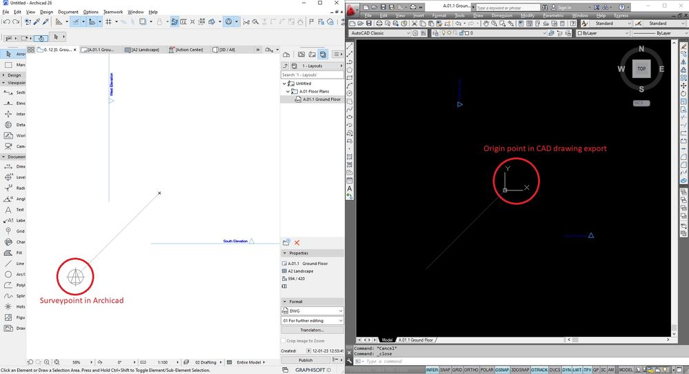

Rubia,
Thanks for explaining the method.
We tried exporting the single layout from Archicad to CAD, using proposed workflow, but still we are getting origin point in CAD not matching with Surveypoint in Archicad.
We are using Archicad 26. Please review attached screenshot also i have posted PLN file with just one layout in it.
Thanks again for looking in to this issue.
Ernest Atanasiu
The explained method is not working for me. I tried in AC25 and AC26 with a new file based on the INT template.

Ernest Atanasiu
Thank you for the clarification.
You are suggesting that placing the drawings into linked xref files should work but I could not replicate the result. No matter how I match the file's origin, it still keeps the origin at 0,0 (archicad file origin = dwg origin)
In understand the reason for the limitations. However, when saving Xrefed archicad views, it should work with real-world coordinates based on the survey point, at least for views originated from stories plans. Having the option to match the file's origin with the survey point is useless since there is no way to use it.
