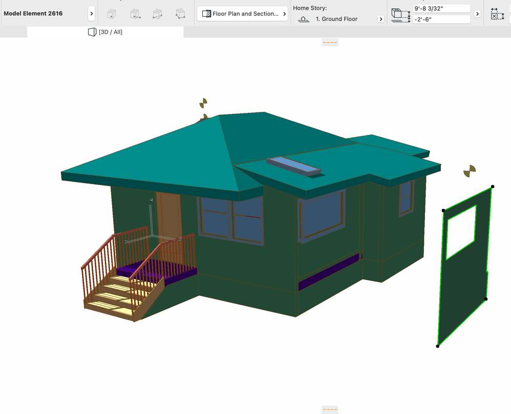

Ok, the problem I'm having right now is that the revit file I was provided that was exported as an IFC has exploded elements. For example the walls are made up of multiple surfaces (see image I posted of house), and not a single assemblie. I'm trying to obtain information of ways to keep elements as they were in Revit so I can edit them in Archicad as I would if they were originally created in Archicad. I can't do anything with an exploded wall made up of multiple surfaces, it should be one wall made of an assembly just as if I were using the wall tool in Archicad.

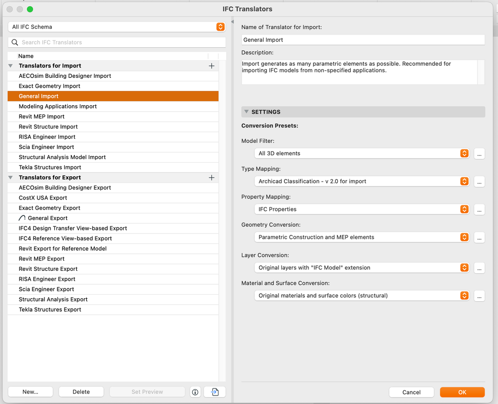

Might you have used the "Exact Geometry Import" option?
Hi Lingwisyer,
Could you elaborate? Where would I find that option, walk me through?
