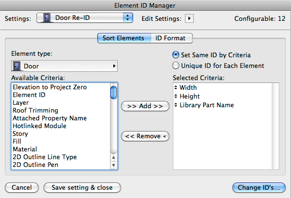

You have to click the "Change ID's..." button. 🙂
Attached is an example settings set (you can save them) that gives the same ID to all doors that are the same width/height and library part name... The numbers will be ordered by size as well, since the size criteria were given first.
I never click the button on THAT tab (Sort Elements)...
AC 28 USA and earlier   •   macOS Sequoia 15.4, MacBook Pro M2 Max 12CPU/30GPU cores, 32GB
Karl Ottenstein
Moderator Emeritus
...but rather on the "ID Format" tab, where I can see a preview to verify that the ID is what I want. Clicking the button there, will then give a list showing what will happen. Confirm it and it is done. 🙂
