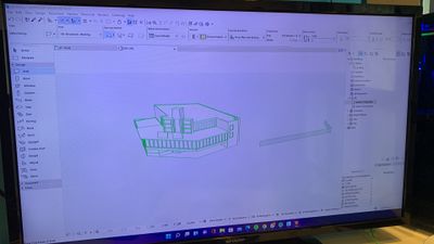

I have a site model I want to import from SketchUp, I tried saving SketchUp file as 2017 then directly import to Archicad but the site Model doesn't show. If a different component is put in that SketchUp file it will show in Archicad but the actual site model won't show.
I tried importing the same site model to Revit and it shows, when I try exporting it as an IFC to later import to Archicad the same site model won't show, it's just empty. Another drawing will import but the site model won't show.
Please help this is for an urgent school project.

Thank you for your response, however I checked the Renovation filters and it's currently showing all nothing is on hide. All my layers are turned on but nothing. I can select the model import but it's just invisible.
I see from the last images your renovation filter is set to '01 Existing Plan'.
This will hide any 'new' elements.
Try changing it to '06 Show All Elements'.

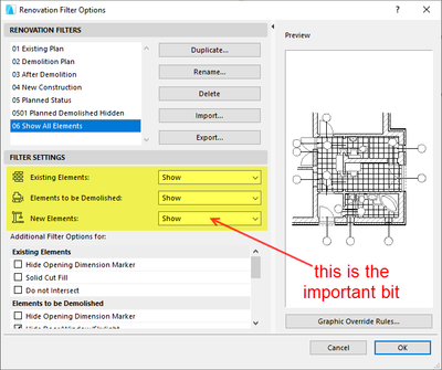

OK, we obviously have different templates (setups).
Maybe your Existing Plan is set to show all elements.
Make sure it is set to show all like this.
If not then just create an "06 Show All Elements" filter.

I set everything to "show" just like in your pic, but no change.
