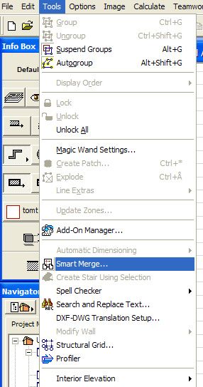

I see Smart Merge in manual and on line Help but not in File>Merge.. or XREF menu, any idea how I can access it?

Joseph.
It should be here.

Thanks,
I was looking in File menu and not Tools.
Thanks very much.
