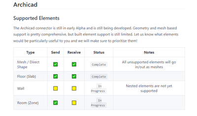

https://speckle.systems/tutorials/getting-started-with-speckle-for-Archicad/
note is on Alpha state, current support:
P.S: Still not published, seems that we need to wait for the upcoming update of Speckle Manager 2.5
