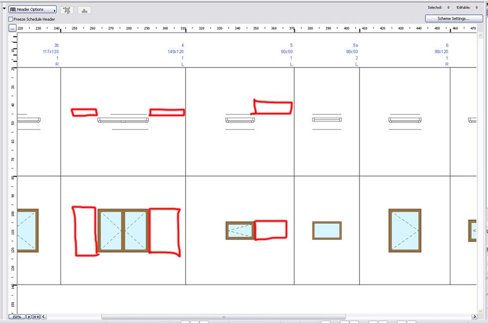

Is there a way to get sunshades together with windows in schedules, in 2d symbol and front view?

it look like library 12 works fine, but when I use library 13, 14 and 15 sunshades will not show in schedules.

Towards the end of this post you will find the answer.
http://archicad-talk.graphisoft.com/viewtopic.php?t=35941
The shades have been scripted so they won't show in the schedules.
You will need to edit one of the window macros but the problem with that is that because it is a standard Archicad part if you ever update the library you will have to do this all again.
And you can't save the macro with a new name because the windows won't be able to find it.
GS should add a parameter to allow the sunshades in the schedules or not rather than scrioting them as off.

Thank you Barry, I did rearrange WallholeFraming as you describe and now I have sunshades and casing in schedules, a friend in need is a friend indeed.

I'm using Archicad 21 and in WallholeFraming.gsm I can find this line of code in the master script, which is a little bit different from the one the pos you are referring to.
! Interactive Schedule and Listing related display options
if GLOB_SCRIPT_TYPE = 2 | GLOB_SCRIPT_TYPE = 3 then
if GLOB_PREVIEW_MODE = 2 then ! IS but not surface
if not(bShowCasingOnLists) then bDrawOutsideTrim = 0
if not(bShowCasingOnLists) then bDrawInsideTrim = 0
if not(bShowSillOnLists) then bDrawSill = 0
if not(bShowBoardOnLists) then bDrawBoard = 0
bDrawThreshold = 0
bDrawShutter = 0
endif
endif
Any of the options I've tried seem to work.
Can you help me?
Thanks!
Can you help me?
The piece of script mentioned in the other post in in the 3D script.
It is the 3D script that will display the elevation and 3D views that you can see in the schedules.
