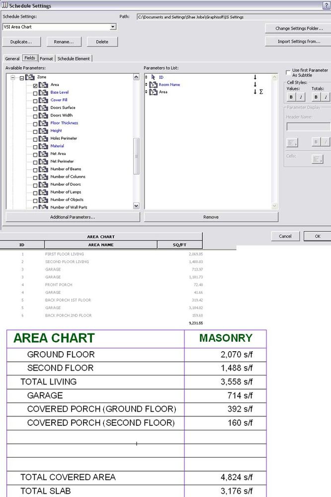

Here is a try I did of this a few months ago, my only issue is that I cannot get items to show as one, and I cannot exclude some areas from some calculations and include it in others, like the lowest diagram. Of course the schedule was made in ver9. And I havent bothered to work it in 10, just because 9 didn't do it and the scheduler still looks the same.
Any pointers?
