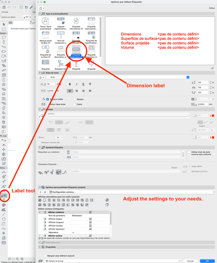

Hello,
is there a way to show Fills area size in both sq m as well as sq feet? Like it is possible for zones and dimensions in Archicad?
Additional question... CZE version of Archicad shows whole name "square foot" on the layout and takes a lot of space covering other important information... is it possible to change it inside of Archicad to show custom name = sq ft ? Thank you in advance!

To add the labels :
1 - Activate the Label Tool, open the Tool options, select the dimension Label and adjust the settings to your needs.

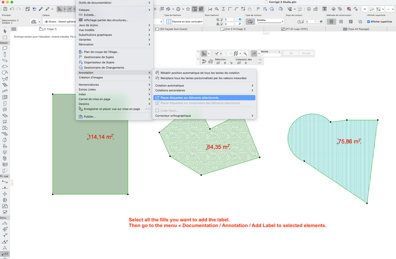

For the second unit you can add a dimension label linked to the fill and set to show the surface in the unit you want.
For the name of the unit I don't think it's possible to change that, in France the text is "pied carré" so I think it's country version dependent.
Maybe with the INT Archicad version ?

magdak
Hi BrunoH,
thank you for answer, yes in the INT version, it works as "sq ft" but we do not use it, unfortunately. As for Fill, where can I add the dimension label? Thank you in advance.
