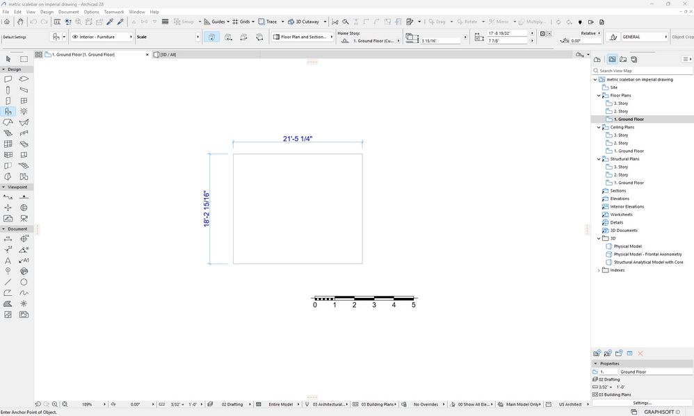

I am doing a small project in imperial units. All the project settings have been changed to imperial yet when I insert the default scale bar from the Object Tool I always get a metric scale bar.
The view has been saved out with all the imperial settings yet I still get a metric scale. Really quite annoying.
Anyone know what I'm doing wrong here? Sample screenshot included..

That is an object, you will most likely have to manually tell it that you are using imperial units. Also, given this question is about an object, you should probably provide the name of said object as well as the library localisation / libpack you are using.
Ling.
ps. If that is the standard 28 Scale object, it does not seem to include anything for imperial conversion...
pss. You could possibly use my scale bar with a 2.54 Scale Unit
https://community.graphisoft.com/t5/Libraries-objects/Is-an-automatic-scale-bar-possible-on-layouts/...

Have you ever used the default scale bar included in AC before? I have, and this is the first time it has come in as a metric scale and not an imperial scale on an imperial drawing. There is no such setting to 'manually tell it you are using imperial units'. It normally comes in automatically based on the units the drawing is set up for. Hence my question.
For reference, see attached screenshot for the 'location'.

Nope, I have not used it as it's representation never did not suit my needs so I made my own. I looked at it after I posted, and it does not look to be dynamic, nor is there a setting to adjust it.
Have tried loading the Annotation USA libpack, if you are not already using it? Actually, that does not contain anything relevant...
In AC28? Wonder how it does that since the code does not seem to contain anything to do with scaling or detecting the dimension style...

I understand the frustration. Normally it works just fine and adjusts automatically based on the files' units that have been set up. Now, for some frustrating reason it just defaults to metric every single time. Very annoying.

It is possible to code to detect the units being used for dimensions set in Project Preferences
n = REQUEST("LINEAR_DIMENSION", "", format_string)
if you the add this to a simple object, then add;
text 0,0, format_string
then a basic object can detect the format of dimensions i.e.
or for metric
using this principle you can get the object to select the correct style of Scale Bar
if STRSTR(format_string,”f”) > 0 then
                !!! draw “Imperial Scale Bar”
endif
if STRSTR(format_string,”m”) > 0 then
                !!!draw “Metric Scale Bar”
Endif
The Key problem is with the new libraries in Archicad 28/29 you will find Metric elements like the "Scale Bar" creeping in and replacing Imperial versions from the US library.

@Mik001  If I remember correctly you need to download and load the USA Archicad Legacy Objects library (second item on the list of the left menu):

I eventually got fed up and exploded the metric scale bar and manually made an imperial one from there. I'd love to turn it into a parametric object so I can just reload it into future projects, but I'm not smart enough for that!
