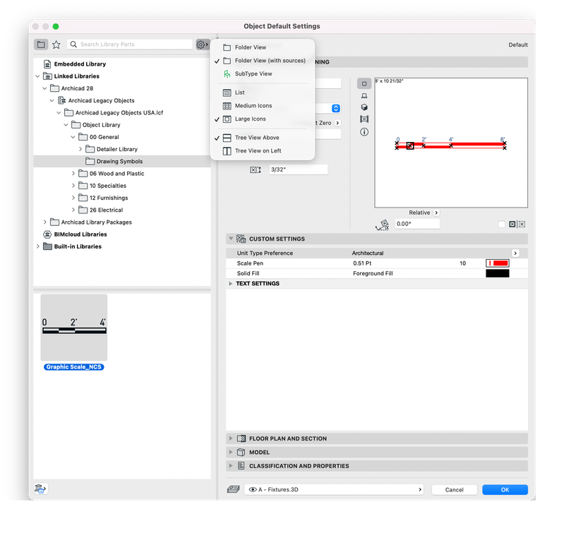

Actually I just checked, and in Archicad 28, the legacy object library was included within the installer. So all you have to do is open Library Manager and load the linked library directly from Application folder: /Graphisoft/Archicad 28/Archicad Legacy Objects
Once you do, you will find the object with the name "Graphic Scale_NCS"
