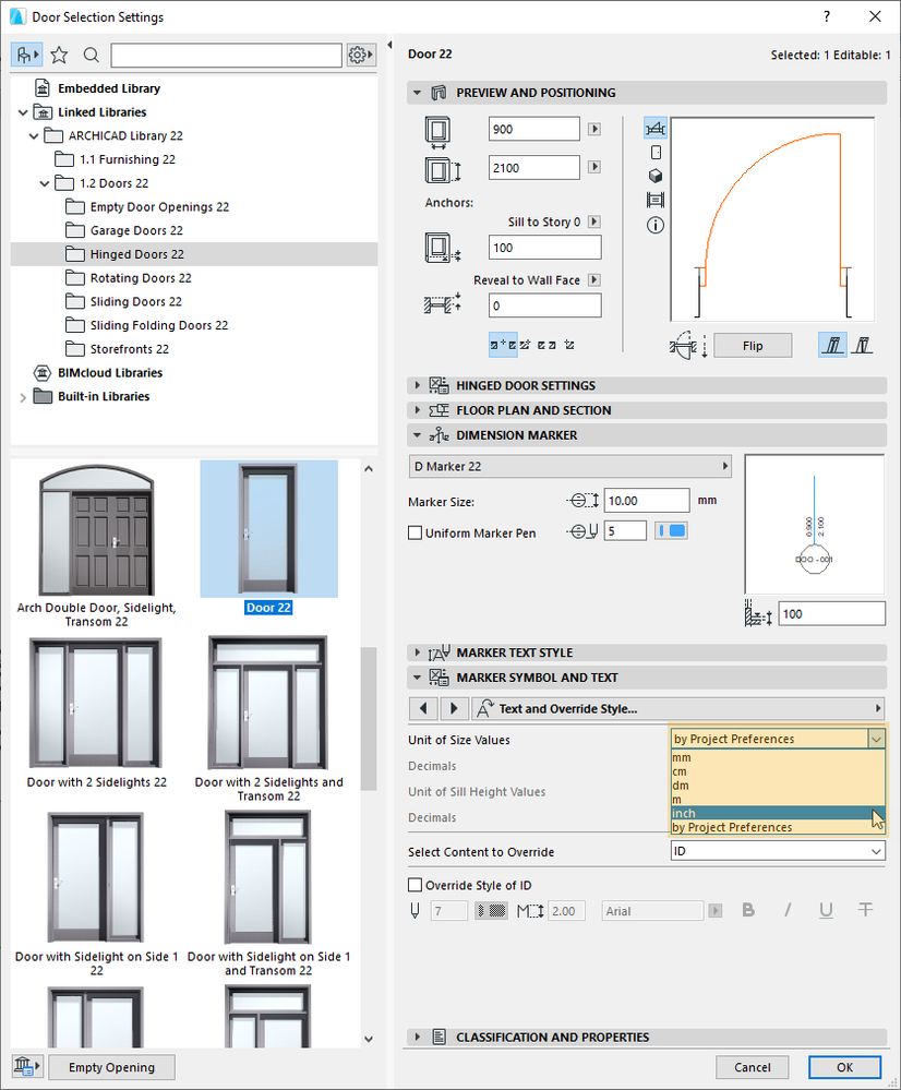

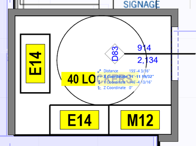

How to set the door opening marker dimension to imperial?
All other door types have the "Builder Dimension 22" option and are showing Imperial units except for this one.

Usually, there is a setting for Doors and Windows that lets you select the unit for the dimensions.
