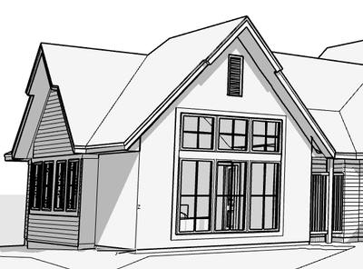

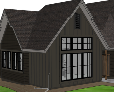

Our saved 3D views, for layouts, are not updating to the current model.
For example: We have saved 3D views created from the "Generic Perspective". The view is adjusted to what we want and apply the 3D style we want then save in a separate folder under 3D views.
The client then, for some reason, wants some changes. The changes were applied.
The "Generic Perspective" view is current with all of the changes, but the Saved 3D view (that we want for our layouts, with specific camera views and 3D style) do not update to the current model. They are missing objects, etc.

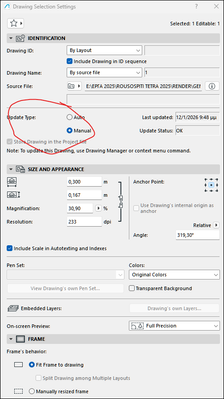

Have you opened the drawing settings on the layout and checked if the auto update is enabled??
2026-06-04 04:29 PM
Thanks for the reply, but that is not the issue.
The source saved view is not updating to the current model.
So, the Layout View will update, but it is just showing the saved view that is not current to the actual current model.
