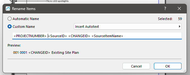

I want to label my published drawings like this:
<PROJECTNUMBER> <SourceID> <CHANGEID> <SourceItemName>
so
001 0001 A Site Plan
All the autotext works except my change id which just remains as the raw text. Why is this not an autotext option?
1 Reply 1
max_min
Change ID is intended to identify a change, at the element/view level, furthermore a single layout may have multiple changes with different change IDs. What you likely want is Revision ID or Transmittal Set ID.
See: Available Autotexts
Layout Revision
Current Revision ID
<CURRENTREVISIONID>
Current Revision Transmitted By
<CURRENTTRANSMITTEDBY>
Current Revision’s Transmittal Set Date
<CURRENTTRANSMITTALSETDATE>
Current Revision’s Transmittal Set ID
<CURRENTTRANSMITTALSETID>
Current Revision’s Transmittal Set Name
<CURRENTTRANSMITTALSETDESCRIPTION>
