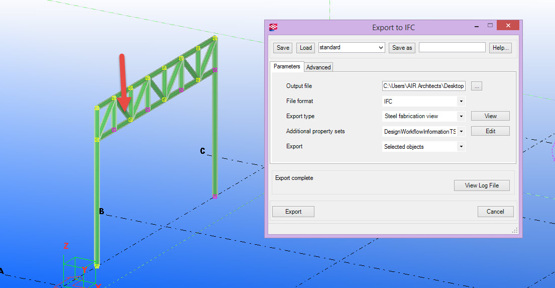

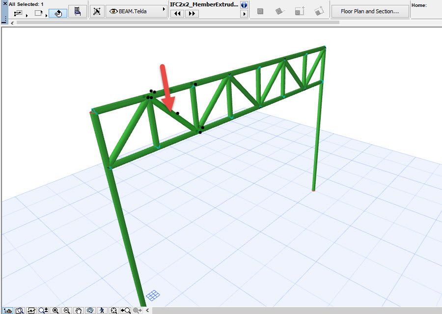

I'm trying to understand if inclined beams export from tekla in IFC are imported as inclined beam in ARCHICAD; but it seems they are converted in objects.
Have anyone found any setting to solve it.

You should check the inclined Beam geometry exported from Tekla in an IFC Viewer, such as Solibri Model Viewer.
If the Beam is an extruded geometry, then it may import into ARCHICAD as a Beam. But if it is a BREP (Boundary Representation) then it definitely won't. In that case it will only import as an Object (or Morph, depending on the IFC Translator Setup).
