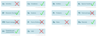

It's not just you and it's not just the Zz CAD table missing:
I guess some tables have been left out as they are not directly related to Archicad (output) capabilities.

Thank you Miha_M for your response.
This seems strange as these were included in previous versions, but you may be correct as these may be purely for exporting 3D elements only.
I tried to classify a Grid Line but not sure which table to use.

I'm not sure how this works with UniClass, but the Grid elements are converted to IfcGridAxis if they are included in export to IFC, even if you assign them to any unrelated classification position.
But you could also tweak the UniClass xml and add the Zz table part with Zz_35_40_80, which you have been probably looking for.
