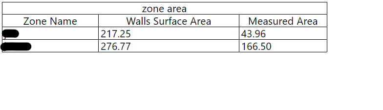

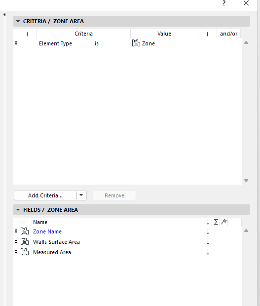

I've created a schedule to get the wall surface area's using zones (attached is the criteria).
However, when the wall heights (square footages) are modified, the schedule doesn't update, I have to close the schedule and re-open it... What am I missing? It seems like the schedule should update automatically (like a door schedule does - delete a door and it removes it immediately from the schedule)...

Think I figured it out - must update zone in order to populate...
