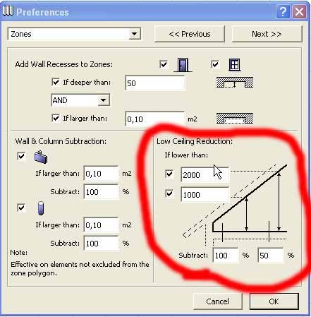

What is the standard for low ceiling reduction?
Mats_Knutsson
Mentor
Is it the GS way (see attached image) that is world wide standard? In sweden we use only one height constraint and then enlarge the zone area with 60 cm to calculate ("liveable area"). The way AC is defining it with two different height values doesn't work for me. Are we strange up north or what?

Yeah our Height is 5-feet. So we just set both at 5-foot.
Thank you Jay!
Sorry for us then...I's a shame on such a nifty function that we have a different way of calculating this..
/Mats

Every building code has a different way ...
... that is why the dialog box has all those checkboxes - so that you can set it up to your standards.
Then I vote for EU standards...in my dreams... Figure shows how I would like it...
