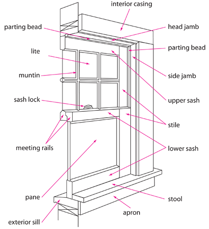

I have noticed that the same window, if located in a different wall type, will not be included in the schedule as being the same. Is there a way to disable this kind of sorting for window schedules so the quantity of same windows is accurate no matter how different the wall thickness is?
I hope this is not a bug because I am saving those up for Beta Testing
Just to be clear, if you have identical windows in 2x8 walls and 2x6 walls, they will not be combined in the window schedule because the wall thickness is different. There is no difference in the window thickness, just the window jamb widths. ( side jamb, head jamb)
