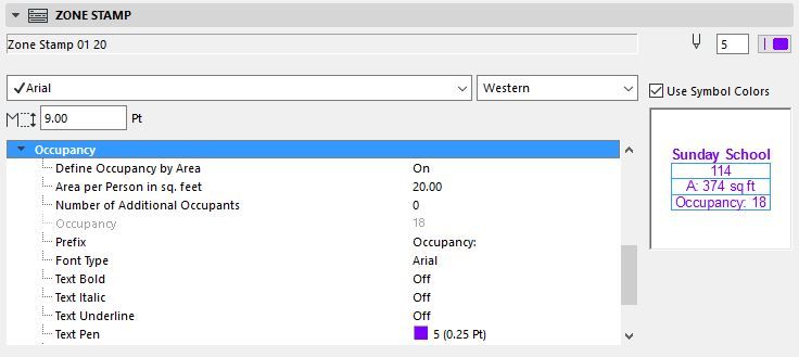

Is there a way to round up the occupancy number without tweaking the 'Area per Person in sq. ft.' or adding 'Number of Additional Occupants'?

You would have to code it in the GDL script for the zone stamp.
That figure is simply based on the number of people per SQF multiplied by the area of the zone.
You would then have to code in the script that you want to round it up by using a mathematical equation.
I would be guessing that is why that have added the 'number of additional occupants' parameter so the user can easily adjust the occupancy at their will rather than having it round up/down automatically.

I do not want to take a long time, but I need help. I can't understand how to do ''Round up Occupancy", I want, if my ROUND is 46.9855, Result will be 47,00. I Have archicad 21 and could not find a way how correctly write down on parameters. I have good knowledge working in archicad, but I don't know how to write down any scripts.

It has expressions in properties that can allow you to create this type of rounding without having to worry about GDL.
If 22 is not an option then what zone stamp are you using?
Eduardo Rolon
What I used to do prior to 22 was to create a Schedule listing Zones and Occupancy and another Property for the "roundup".
Export this to Excel
Open in Excel and format to round up and then import back into AC
