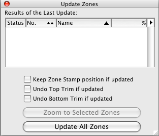

Update Zones palette shot attached. Doing a rebuild and regenerate also updates the volume seen in the stamp (cmd-option-shift-R, if defined in your WE - probably ctrl-alt-shift-R on Windows).
Karl

Thanks Karl.
Seems I had set the heights manually OK but had not initiated the update. Now its all OK.
I'll check out the solid element operation and look for the trim zone command because that will be appropriate for some zones.
Thanks again
Rob
