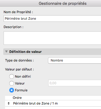

2024-10-30 11:09 AM
Maybe with a property of type number with formula
Only problem the unit of length will not be displayed in the total
