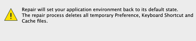

Hi Barry,
I tried to reinstall a fresh version of ArchiCAD 28 but the installer looked like it was going to try to "Repair" my copy of ArchiCAD, which was going to change things that I didn't want to modify. There used to be an option of selecting where to install the application, but that has apparently been deleted. Is there a way to install a clean version of AC 28?
Thanks.
Steve Pribyl
MAC OS Sequoia 15.5
ArchiCAD 28
This is the "Repair" notification that comes up and there's no way to bypass it that I can see.

Classifications and properties have nothing to do with the installation of Archicad.
They are stored in the file itself.
A 'repair' will give you a clean install and will revert you back to the initial build (3001).
Or you can completely un-install and then re-install Archicad.
But there is no need if you just want to import the C&P from another file.
Re-installing will not affect any files you have but will reset your Work Environment and DXF & IFC convertors back to their defaults.
All of which you can export before you re-install and then import back into the new setup.
