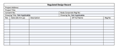

Is it possible to create 2 sets of revisions for each layout? With or without using the changes tool. We currently have to use text for one of the revision sets.
Bit of context - in NSW under the design building practitioner act we have to include a standard title block (regulated design record) in additional to our usual title block to keep track of "declared designs" - these are official issues that gets uploaded to the planning portal. In this title block, we use revisions 1, 2, 3...etc.
We have our usual title block which we use on the day to day- issuing to client for review/ consultant coordination etc and we use A, B, C...etc.
What's best way to go about setting this up?
