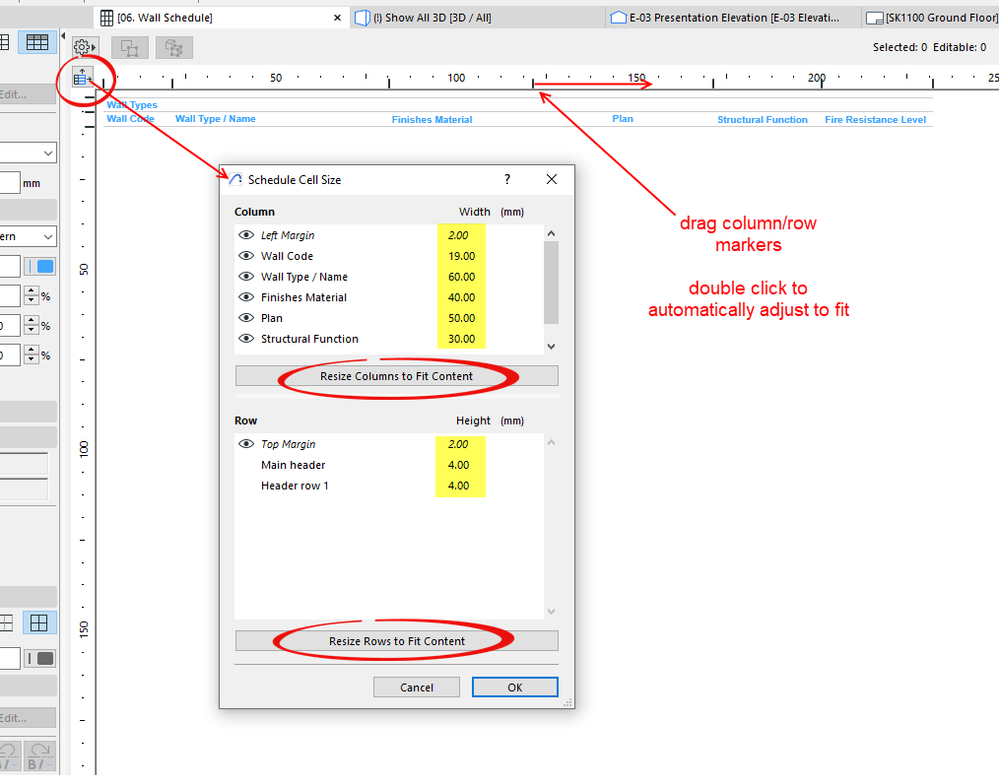

Is it possible to set a fixed dimension for columns or rows in a schedule automatically and globally? If so, how?

There are many options available to you.
