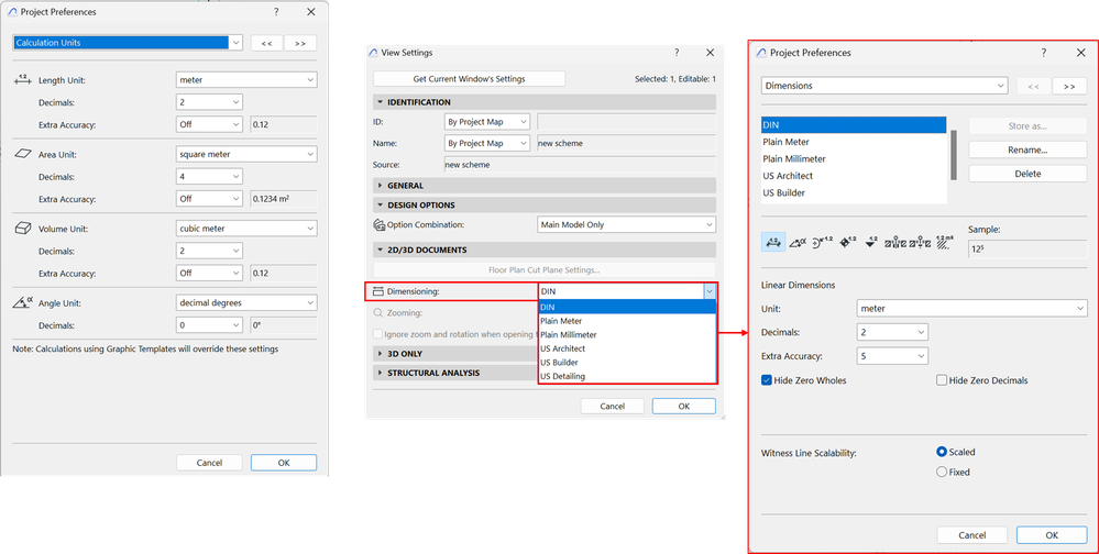

Units and decimals for Calculation Units can be set at Options> Project Preferences> Calculation Units...
Units and decimals visible for dimensions (ex: areas, legths, etc.) can be part of eachView Settings as 2D/3D DOCUMENTS/ Dimensioning  based on Options> Project Preferences> Dimensions...
Schedules must be saved as views in order to apply its View Settings with Calculation Units and Dimensioning preferences.

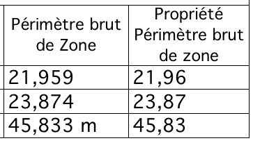

Maybe with a property of type number with formula
Only problem the unit of length will not be displayed in the total
