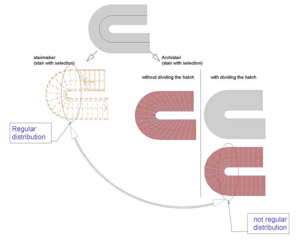

1- is it possible to get the same thing in archistair as stairmaker (see the attachement) !
2- And for a special stair with selection, how do you specify a landing area in StairMaker (not achistair)
thanks

for the moment what i have done is:
1- create the curved stair in Stairmaker:
2- Draw a hatch over the stair;
3- this hatch is then divided.
4- create a new stair with Archistair;
It the only way to have what i want from archistair...
As for the second question i'm still wainting....
