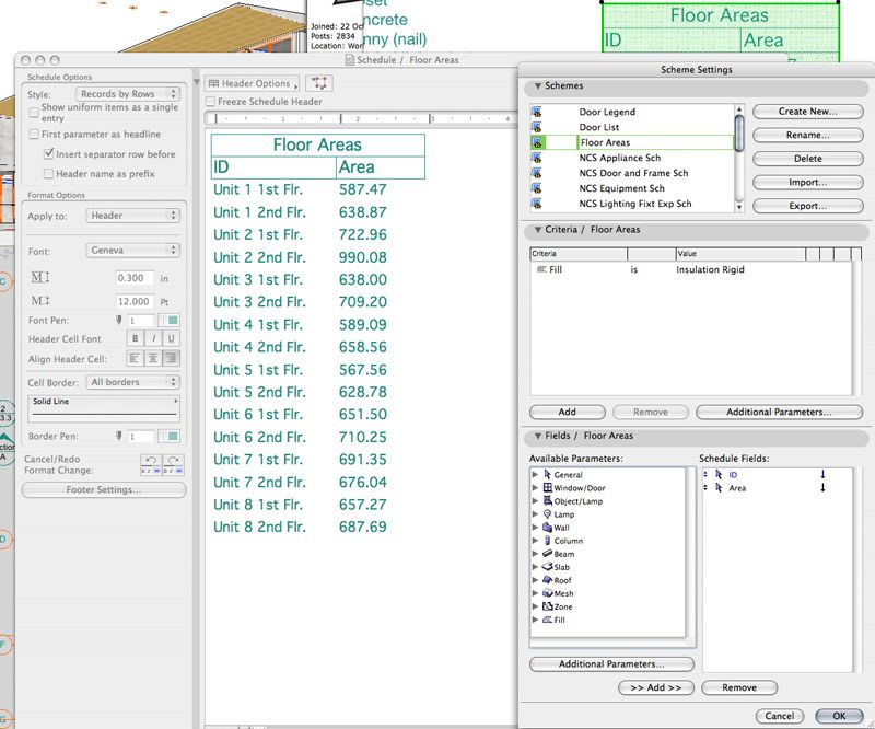

I'm having some trouble with formatting the schedule. Can you insert totals in the schedule (eg adding up floor 1+2 of unit one above the info for unit 2?) and have a grand total below? I see there are options to edit characteristics for these over on the left side of the schedule options...Any suggestions?
Link
Graphisoft Partner
Graphisoft Partner
Check the reference guide for sorting & totalling the schedue fields.
Cheers,
Link.
Is this what you are looking for?
I added Floor to the listed parameters and made totals for the floors. The flag and the Sum sign are the key to that.
that's great laszlo thanks - what if i have two fills on different floors that i would like to add up? (eg there are 4 units each with two floors, how would I get those pairs of fills to add in the table?)
Then the two fills belonging to the same unit should have the same ID.
The ID should be first and it should be flagged, the Surface (Area) should have the SUM sign.
