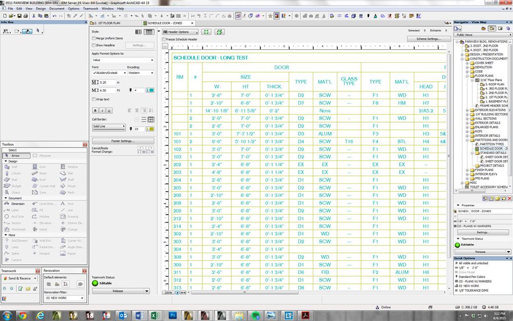

can't get certain door room numbers to display in schedule
I can't seem to get the room number for certain doors to show up on the door schedule...see the blanks at the top of the attached schedule. The doors are set to automatically show the zone number but certain ones just won't do it no matter how i move the door tag or zone outline around. It's frustrating, too, because I can't just mask over those doors on the schedule and overwrite, because they are not in the right row.
Any one come across this?
Thanks

Bill,
My guess is that there are issues with zones and the relationships of the doors to the zones:
- Is the zone for these doors actually touching / covering the entire door?
- Do you have overlapping zones?
Scott
Bill
I agree, but the schedule is returning other, similar doors properly. It's only certain doors that I can't seem to get to show up. I am spending A LOT of time adjusting the edge of the zone, and the settings on these doors, and just cannot get them to show like other doors in the project.
It's frustrating because I don't know of a workaround that keeps me within Archicad. I know I can set up a dummy text excel schedule that will look "similar" but I'm really trying to avoid that, and I am stymied in terms of creating this door schedule.
