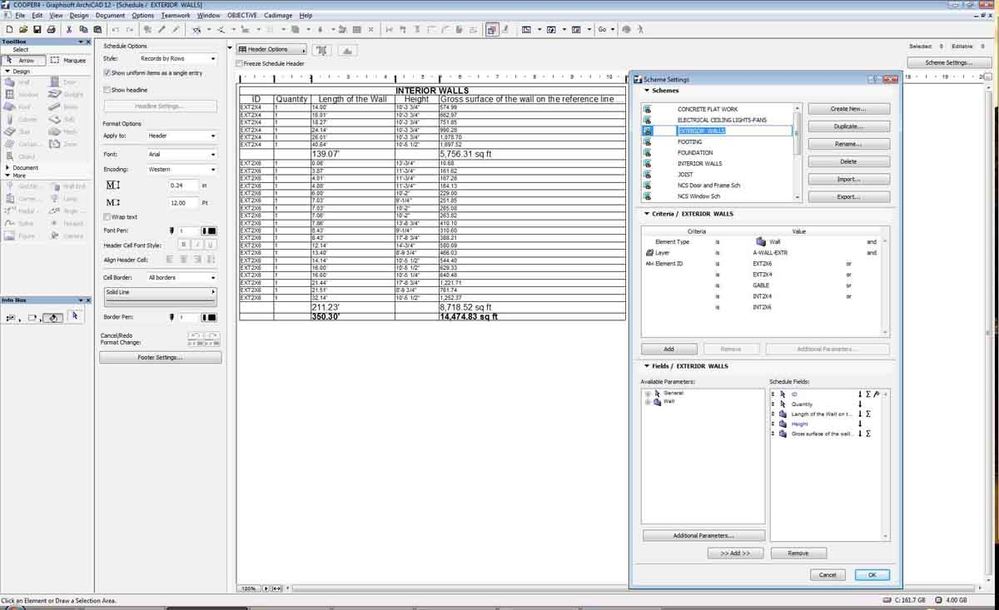

when using custom wall profiles my calculation of wall surface seem to go stupid. I have 128 lin ft of 10' tall walls which is 1280 sq ft of surface for siding, however when i used a custom wall profile w/ base and sheetrock on the inside and the exterior have 7/16" wafer sheathing and siding dropped below the insertion point by 2 1/4" to lap down to my foundation my wall area using the exact same schedule cal over 6000 sq ft of wall surface. So my question is does using custom walls with the wall profile tool screw up all the calculations. In the scheme settings i have the surface for the wall on the reference line side selected on both calculations. any suggestions?

THIS is what i am doing built in schedules, then selecting the scheme setup that i have for exterior walls based on ext2x4, ext26, for id, on the approiate
layer. and then i have total wall surface on the reference side.
it calculates the wall length ok but the surface is not corrrect by a lot.

karl i am not using components. just schedules. not doing in depth parts just the surface of the wall for siding it was real easy before i started using complex walls.
no it is not a metric thing, if i have a 40'x 10' wall it may cal it @ 1582 sq ft of surface on the reference line side of the wall, fairly easy to see that is not correct.
I really don't' know what it is calculating.
It would nice if you could identify the surface you wanted to put in the schedule, ie core surface, waincote surface subsiding surface and so on
I have a feeling that it is calculating the surface of every i have on the wall and all edges and the back side of each of the surfaces. (i have 7/16" wafer sheathing, 7/16" siding, and core of the frame wall 2x6 or 2x4.

AS you can see in the image i have the length of the wall and also included the height and the information I am trying to extract is the surface on the reference side of the wall when you mulitply the length of any walls by the height it does not match the surface calculated by the schedule.
