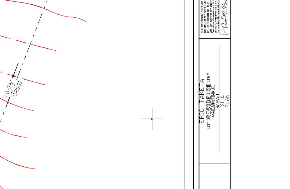

I am using ArchiText Western in ArchiCAD. I have AutoCAD on my computer but have no idea how to use it.
I am attaching screen shots of the layout in Plotmaker and the DWG opened in AutoCAD.
I'm thinking that this is probably too easy a question. The export from ArchiCAD to DWG must be happening thousands of time every day. How can I get the font in the DWG to look like the font in ArchiCAD (all on the same computer)?

johncassel wrote:Don't have to use it; just open the drawing to see what is happening.
johncassel wrote:As your screen shots are not up yet, please also upload a screen shot of your Translator settings.
johncassel wrote:It should work on the same computer, as the same font should be recognized in both applications. That is, unless your Translator says differently.

Translator settings as requested.

BTW I did try putting Arial under AutoCAD font and nothing different happened.
