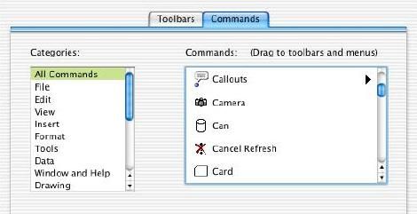

How does it work? it's an alternative to OLE (which doesn't exist on OS X for ArchiCAD/PlotMaker)
1.) Tools-> Customize (go to right column)-> Camera
2.) Drag this Camera icon to your upper toolbar in Excel for an easy shortcut to the tool
3.) Highlight cells you want to capture
4.) Click on Camera icon that you created
5.) In PlotMaker Layout, Paste the captured cells

JCovarrubias
Graphisoft Alumni
Graphisoft Alumni
screenshot below
