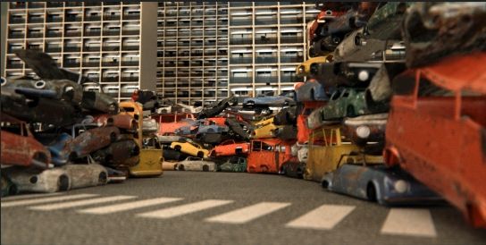

This image is rendered in 1:30minutes.
This is unbiased render like maxell and its faster then artlanits
This is GREAT stuff - new techonolgy is here
Its 10-15 times faster then CPU renders
long live the competiotion
12 minutes render
