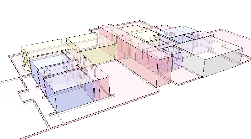

__archiben
zones. with coloured glass materials (to match their category colour if you feel so inclined! )
~/archiben

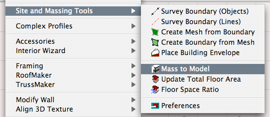

vango wrote:
...anyone know of training that directly addresses layout out spaces (zones) and conitnues on into 3-d massing and schematic design?
cadimage's 'Site and Massing' tools have a feature whereby building masses can be converted into slabs and walls for continued design.
http://www.cadimagetools.com/documents/Site_and_Massing_Tools.pdf
page 12 onwards.
it also allows you to firstly calculate building envelopes for your site based on local planning requirements, although this may well be more new zealand biased . . .
~/archiben
nice looking Zone materials there Ben
i really liked the idea of using Zones for early design work - however I have 2 problems which prevent using this workflow in many situations:
1. Zones don't appear in Sections & Elevations (please vote here)
2. Zones are some kind of 3D-but-not element which will not export to external 3D apps .. such as Cinema 4D for rendering & animations. Not a big issue for some but if you care please vote here
~/archiben
Very sweet materials indeed. Would you like to share the settings? I can't reproduce it!? I guess it's also the settings for the internal engine that does it and I can't get it to look as good as yours.Mats
